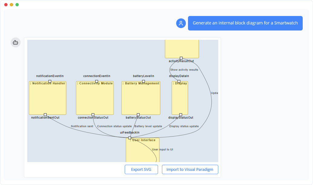

Why Use AI for Internal Block Diagrams?
Modeling the intricate internal wiring of a complex component is a detailed and precise task. An AI co-pilot is an ideal partner for this work.
- Automated «Wiring»: Describe the connections between parts in natural language, and the AI will instantly generate the IBD with all the correct ports and connectors. This eliminates the tedious manual process of drawing and aligning lines.
- Ensure Interface Compatibility: An AI can act as a design validator. By understanding the types of ports, it can flag potential mismatches. «You are trying to connect an ‘electrical power’ output port to a ‘hydraulic fluid’ input port. Are you sure this is correct?»
- Rapidly Explore Design Alternatives: Good design involves exploring trade-offs. An AI makes it easy to generate different IBDs for the same block, allowing engineers to visually compare different internal layouts and connection strategies.
- From Design to Analysis: An AI can use the IBD for more than just visualization. Ask it to «Trace the path of a ‘control signal’ from the ‘Engine Control Unit’ to the ‘Fuel Injector’ part» to perform powerful connectivity and impact analysis.

How to Generate IBDs with AI: Example Prompts
Your prompts should be specific about the parts and their connections.
- Defining the Context: «Create a SysML Internal Block Diagram for the ‘Computer’ block.»
- Adding Parts and Ports: «Inside the ‘Computer’ block, add parts for a ‘CPU’ and ‘RAM’. Add a port named ‘dataBus’ to both parts.»
- Connecting Parts: «Draw a connector between the ‘dataBus’ port on the ‘CPU’ and the ‘dataBus’ port on the ‘RAM’.»
- Analysis: «Based on this IBD, list all the parts that the ‘CPU’ is directly connected to.»
