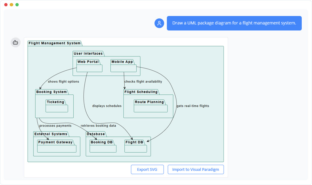

- Instant Blueprint Generation: Describe your architectural vision in natural language, and the AI will instantly generate a clean, clear package diagram. “My application follows a layered architecture. Create three packages: ‘Presentation Layer’, ‘Business Layer’, and ‘Data Access Layer’, showing the correct dependencies.”
- Enforce Architectural Principles: An AI can act as an architectural guardian. After generating a diagram, ask it to analyze the structure: “Review this package diagram. Are there any circular dependencies?” This provides immediate feedback, helping to catch architectural flaws before they are written into code.
- Effortless Refactoring: As a system evolves, its structure needs to change. An AI makes planning these changes simple. “Split the ‘Business Layer’ package into two new packages: ‘Order Management’ and ‘User Management’.” The AI can generate a new “to-be” diagram, allowing you to visualize the impact of the refactoring.

- Basic Structure: “Create a package diagram with three packages: UI, Core, and Infrastructure.”
- Dependencies: “Draw a dependency from the UI package to the Core package.”
- Hierarchy: “Nest two new packages, ‘Controllers’ and ‘Views’, inside the UI package.”
- Analysis: “Analyze this package structure. Does it have any circular dependencies?”
- Refactoring: “Refactor this diagram. Combine the ‘Core’ and ‘Infrastructure’ packages into a new package called ‘Backend’.”
