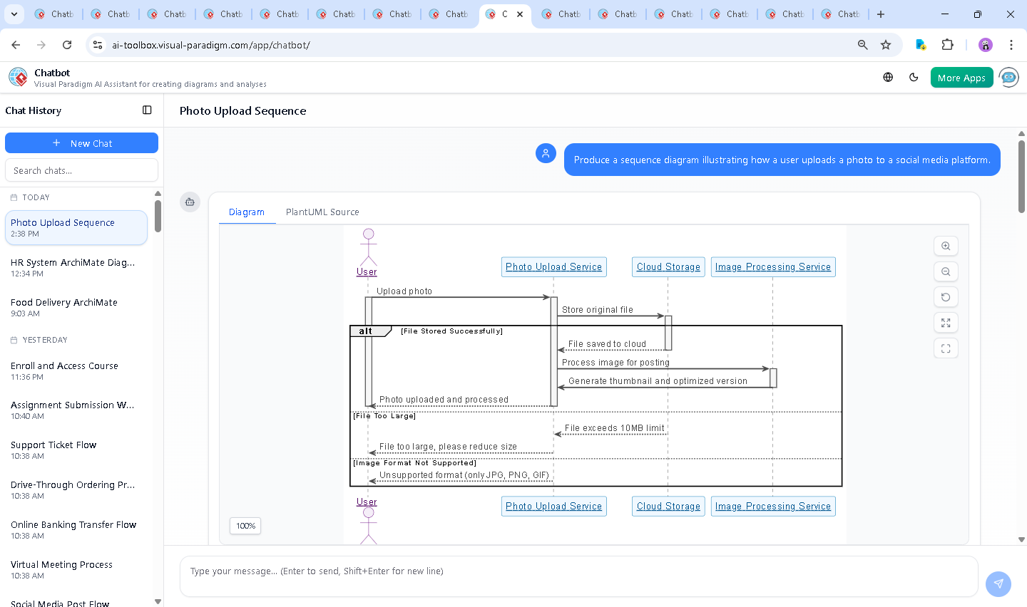

The journey began with a simple request: “Produce a sequence diagram illustrating how a user uploads a photo to a social media platform.” The AI Chatbot responded immediately with a fully rendered PlantUML-based sequence diagram, already incorporating key architectural components: the User, Photo Upload Service, Cloud Storage, and Image Processing Service.
But the real value emerged in the conversation. After the initial diagram was generated, the user asked: “Explain this diagram.” Instead of a static explanation, the AI delivered a structured breakdown—highlighting the flow, error handling, and design principles—demonstrating its ability to function as a technical educator and design peer.
When the user requested clarification on specific branches, such as “Explain this branch”, the AI didn’t just restate the diagram. It dissected the alt block logic, explaining how the system handles file size and format constraints with targeted feedback, ensuring the user understood not just what the diagram shows, but why those branches exist.

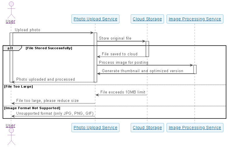

Visual Paradigm AI-generated sequence diagram showing the flow of a user uploading a photo to a social media platform, including cloud storage, image processing, and error handling.
AI Generated Sequence Diagram: User Authentication Process Example (by Visual Paradigm AI)

The sequence diagram is built on a foundation of modularity, resilience, and user-centric design. Here’s a detailed breakdown of the logic:
1. User Initiates Upload
The User triggers the process by selecting a photo. This action sends a message to the Photo Upload Service (PUS), which becomes the orchestrator of the entire flow.
2. File Is Sent to Cloud Storage
PUS forwards the original file to Cloud Storage (CS). This separation ensures that the storage layer is decoupled from the upload logic, enabling scalability and redundancy.
3. Success Path: File Stored, Then Processed
If the file is successfully stored, CS confirms back to PUS. PUS then sends the file to the Image Processing Service (IPS), which generates a thumbnail and optimized versions for web delivery—critical for fast loading and responsive UIs.
4. Error Handling: Proactive Feedback
The diagram includes two alt branches to handle common failure modes:
  • File Too Large: If the file exceeds 10MB, CS rejects it. PUS informs the user to reduce size—preventing failed uploads and improving UX.
  • Unsupported Format: If the file is not JPG, PNG, or GIF, the system blocks it early and provides a clear error message.
These branches aren’t just decorative—they reflect real-world constraints and demonstrate how the system anticipates user mistakes and guides them toward success.
5. Final Confirmation
On success, PUS sends a confirmation back to the user, completing the cycle with a clean, actionable result.

Screenshot of the Visual Paradigm AI Chatbot interface showing a live conversation about a sequence diagram for photo upload, with real-time diagram generation and explanation.
