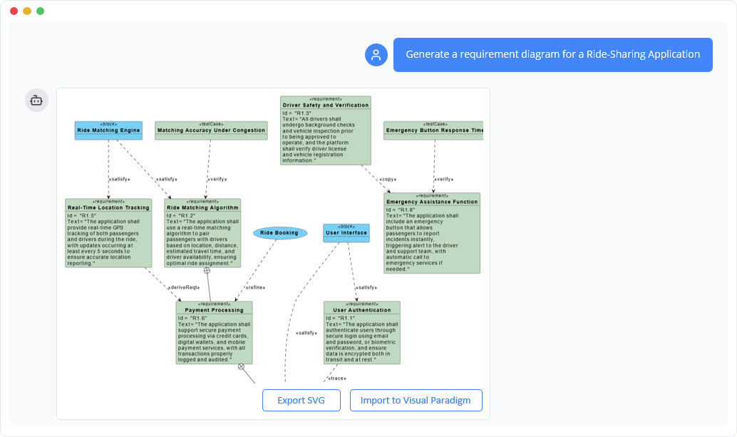

How to Generate Requirement Diagrams with AI: Example Prompts
Your prompts should focus on the requirements and their relationships.
- Defining Requirements: « Create a SysML requirement with ID ‘R-01’ and text ‘The vehicle shall accelerate from 0 to 60 mph in under 5 seconds’. »
- Creating Relationships: « Show a
<<deriveReqt>>relationship from requirement ‘R-01’ to a new, more specific requirement ‘R-01.1’. » - Linking to Design: « Create a
<<satisfy>>relationship from the ‘Powertrain’ block to requirement ‘R-01’. » - Impact Analysis: « Based on the model, list all the requirements that are satisfied by the ‘Braking System’ block. »
