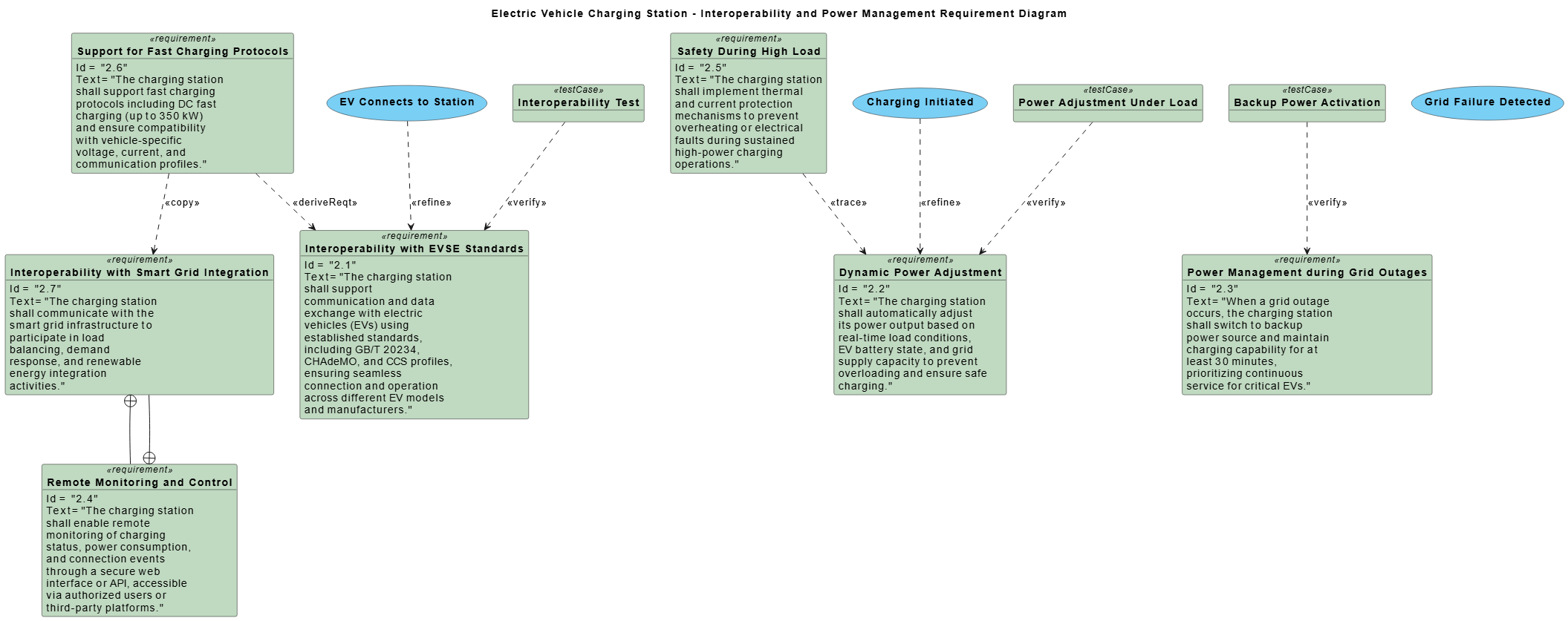

It began with a simple request: “Create a SysML requirement diagram for an electric vehicle charging station focusing on interoperability and power management.” The AI Chatbot responded instantly with a fully rendered PlantUML script, structured for SysML compliance and ready for visualization.
But the conversation didn’t stop there. When the user asked, “Explain this diagram,” the AI didn’t just list elements—it provided a layered breakdown, explaining the purpose of each requirement, use case, and test case, and how they interconnect through formal relationships like $refine, $verify, and $deriveReqt.
Each follow-up query deepened the design. When asked to refine the logic, the AI clarified that req06 (Fast Charging) is not just a standalone feature—it’s a derivation of the broader req01 (Interoperability), ensuring that high-speed charging doesn’t compromise compatibility. Another request—“Explain this branch”—led to a detailed explanation of how req07 (Smart Grid Integration) is contained within req04 (Remote Monitoring), highlighting the layered nature of system capabilities.

The generated SysML Requirement Diagram is built on a foundation of systems engineering best practices. Here’s how each element contributes to a resilient, scalable charging station:
✅ Core Requirements: The System’s Foundation
  • req01: Interoperability with EVSE Standards – Ensures compatibility with GB/T 20234, CHAdeMO, and CCS, enabling universal EV access.
  • req02: Dynamic Power Adjustment – Uses real-time data to modulate output, preventing grid overloads and optimizing charging speed.
  • req03: Power Management During Grid Outages – Maintains service for up to 30 minutes using backup power, critical for commercial reliability.
  • req04: Remote Monitoring and Control – Empowers operators and third-party platforms to track usage and manage fleets securely.
  • req05: Safety During High Load – Implements thermal and current protection to prevent failures during sustained high-power operations.
  • req06: Support for Fast Charging Protocols – Enables DC fast charging up to 350 kW, meeting demand in urban and highway settings.
  • req07: Interoperability with Smart Grid Integration – Allows participation in demand response, load balancing, and renewable energy utilization.
🔍 Relationships: The Intelligence Behind the Structure
What makes this diagram more than a list is the traceability network:
  • $refine(useCase01, req01) – The act of an EV connecting to the station is a concrete manifestation of interoperability.
  • $verify(testCase01, req01) – The interoperability test is designed to validate this core requirement.
  • $deriveReqt(req06, req01) – Fast charging is a specialized form of interoperability, not a separate capability.
  • $containment(req07, req04) – Smart grid integration is enabled through remote monitoring, showing dependency.
  • $trace(req05, req02) – Safety mechanisms are directly linked to power management, emphasizing holistic design.
These relationships aren’t decorative—they’re essential for compliance, testing, and system validation, especially in regulated industries like energy and transportation.
What sets the Visual Paradigm AI Chatbot apart is its ability to think like a systems engineer. When the user asked for clarification, the AI didn’t default to generic definitions—it provided context-aware insights, such as:
  • Why req06 is a derivative of req01 (because fast charging must still comply with existing standards).
  • How req07 extends req04—remote monitoring isn’t just about status, but enabling grid-level coordination.
  • Why req05 is linked to req02—safety is not isolated; it’s a direct consequence of dynamic power control.

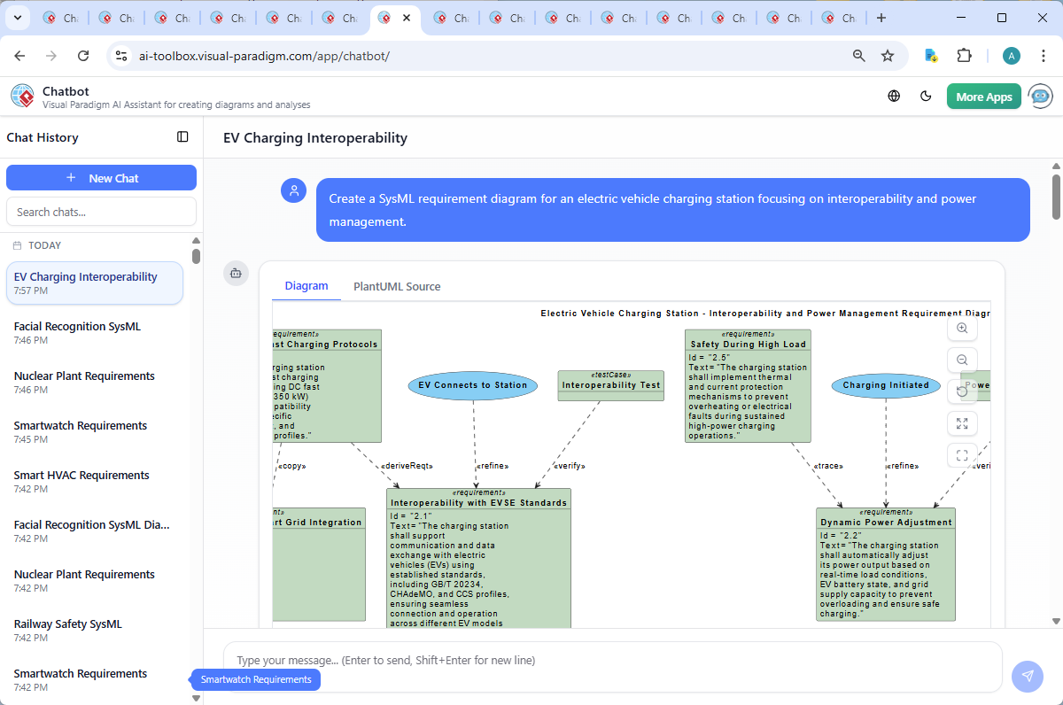

Screenshot of the Visual Paradigm AI Chatbot interface showing the conversation history and real-time diagram generation for the EV charging station requirement diagram.
