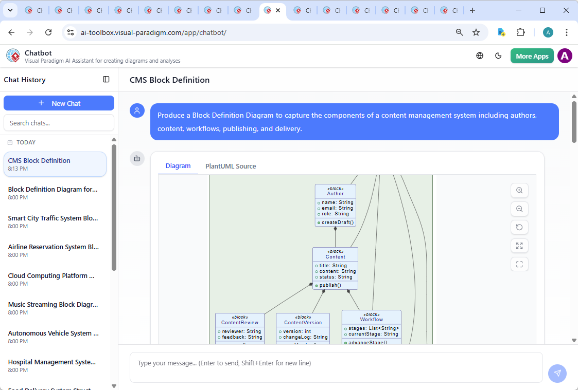

The process began with a simple prompt: “Produce a Block Definition Diagram to capture the components of a content management system including authors, content, workflows, publishing, and delivery.”
Within seconds, the Visual Paradigm AI Chatbot generated a fully rendered PlantUML code snippet, automatically translated into a clean, professional Block Definition Diagram. The diagram included:

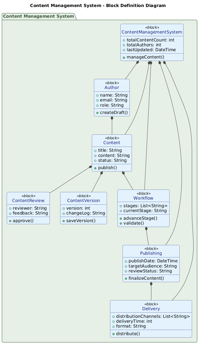

  • Core blocks: ContentManagementSystem, Author, Content, Workflow, Publishing, Delivery
  • Supporting entities: ContentReview, ContentVersion for traceability
  • Relationships: Clear associations showing data flow and ownership

Visual Paradigm AI-generated Block Definition Diagram for a Content Management System, showing components like Author, Content, Workflow, Publishing, Delivery, and ContentVersion with clear relationships.

The diagram is built on the Block Definition Diagram (BDD) standard in SysML, which is ideal for defining system structure at the conceptual level. Unlike class diagrams in UML, BDDs emphasize blocks—abstract or concrete components that represent system elements, with a focus on composition and relationships.
Here’s how each block contributes:
  • ContentManagementSystem: The root block, serving as the container and orchestrator of all other components.
  • Author: Represents content creators, with methods like createDraft() to initiate content creation.
  • Content: The primary artifact, storing title, body, and status. Its lifecycle is governed by the workflow.
  • Workflow: Defines stages like draft, review, approval, and publish. It controls progression and validates transitions.
  • ContentReview: Captures feedback and approval status, ensuring quality control before publication.
  • ContentVersion: The backbone of traceability. Each edit triggers a new version, preserving history and enabling rollback.
  • Publishing: Manages timing, target audience, and final validation before delivery.
  • Delivery: Handles distribution across channels, formats, and timing.
The relationships—represented by solid lines with asterisks—show aggregation and composition. For example, a Content is composed of multiple ContentVersion instances, and the Workflow governs the Publishing phase.

Screenshot of the Visual Paradigm AI Chatbot interface showing a live conversation about the Content Management System diagram, including follow-up questions and AI-generated explanations.
