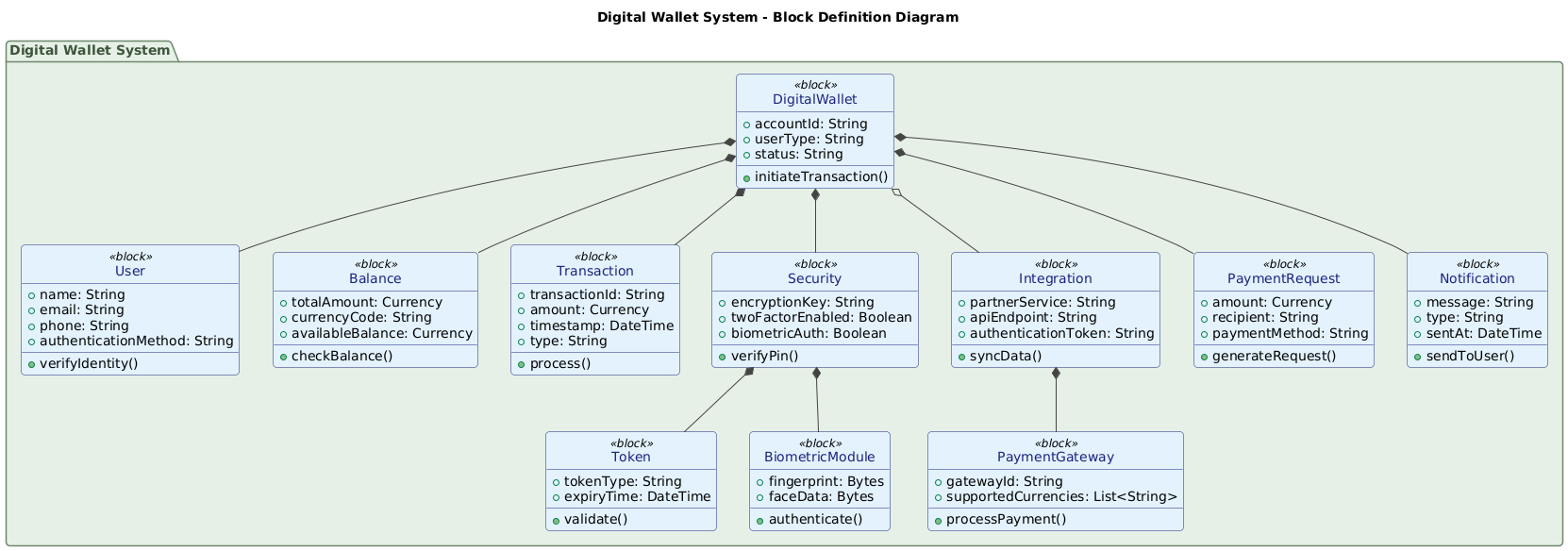

Block Definition Diagram of a digital wallet system showing key blocks like User, Balance, Transaction, Security, and Integration, with hierarchical relationships and decomposition.
AI Generated SysML Block Definition Diagram: Digital Wallet System Example (by Visual Paradigm AI)
The generated Block Definition Diagram is more than a visual—it’s a foundational blueprint for system design. Let’s walk through its core logic:
Core Blocks and Their Roles
  • DigitalWallet: The central container. It owns references to User, Balance, Transaction, Security, and Integration.
  • User: Holds identity data and authentication methods. Key for access control.
  • Balance: Tracks available and total funds, supporting multiple currencies.
  • Transaction: Records all financial actions with metadata (timestamp, type, amount).
  • Security: Enforces encryption, two-factor authentication, and biometric verification.
  • Integration: Enables connections with external services (e.g., banks, payment gateways).
Relationships That Matter
  • DigitalWallet *-- User: A wallet can serve many users, but each user belongs to one wallet.
  • DigitalWallet *-- Balance: Each wallet has one or more balance records (e.g., USD, EUR).
  • DigitalWallet o-- Integration: Integration is optional—used only when connecting to external systems.
  • Security *-- BiometricModule: Security includes biometric authentication as a sub-component.
  • Integration *-- PaymentGateway: External gateways handle actual transaction processing.

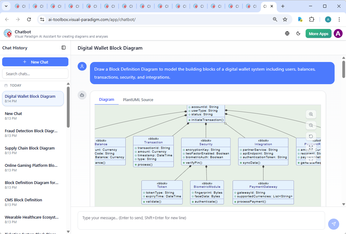

What sets the Visual Paradigm AI Chatbot apart is its ability to engage in a collaborative design dialogue. The chat history shows how the AI didn’t just output code—it interpreted intent, explained context, and anticipated next steps.
For instance, after the initial diagram was generated, the user requested an explanation. The AI didn’t just list components—it provided a structured breakdown with use cases, relationship meanings, and architectural insights. When asked to refine or expand, it offered targeted suggestions: sequence diagrams, security flows, or export formats.
This level of interaction transforms the tool from a diagramming app into a conversational design environment, where every question leads to deeper clarity.
Screenshot of the Visual Paradigm AI Chatbot interface showing a live conversation where the user requests a SysML Block Definition Diagram, receives a detailed explanation, and explores further modeling options.
