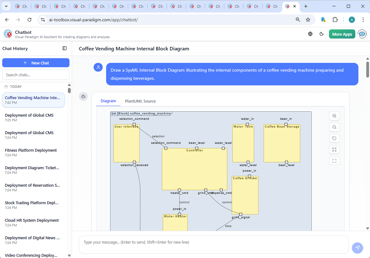

It began with a simple prompt: “Draw a SysML Internal Block Diagram illustrating the internal components of a coffee vending machine preparing and dispensing beverages.” Within moments, the Visual Paradigm AI Chatbot generated a fully formed IBD using SysML notation, complete with components, ports, and interaction flows.
But the real value emerged in the conversation that followed. When the user asked, “Explain this diagram,” the AI didn’t just restate the elements—it delivered a layered, technical breakdown. It clarified the role of each component, explained control and data flows, and highlighted how the structure supports real-world functionality.
That’s where the AI’s intelligence shines. When asked to refine the logic—such as adding error detection or integrating a payment module—the chatbot didn’t just append new elements. It proactively suggested architectural improvements, such as introducing sensor feedback loops and command validation, ensuring the system remained robust and maintainable.

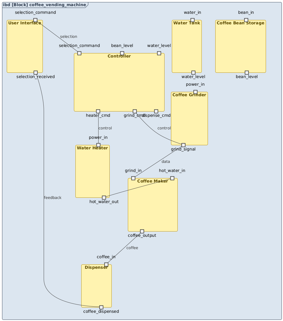

SysML Internal Block Diagram of a coffee vending machine showing components like grinder, water heater, controller, coffee maker, and dispenser with labeled ports and interaction flows.

At the core of this IBD is a system architecture that mirrors actual vending machine operations. The coffee_vending_machine block encapsulates all components, each with clearly defined ports for interaction. The diagram uses SysML’s internal block structure to show how:
  • Input from the User Interface triggers the Controller to validate resources.
  • Control signals flow to the Grinder and Water Heater to prepare inputs.
  • The Coffee Maker combines ground beans and hot water, producing the brew.
  • The Dispenser delivers the final product, closing the loop with feedback to the UI.
Each connection is semantically meaningful: control for command signals, data for status updates, and hot_water for physical flow. This precision reflects the power of SysML’s notation in capturing both functional and physical relationships.

  • When asked to “Explain this branch,” the AI dissected the signal flow from the controller to the grinder, highlighting how the grind_cmd port triggers the physical action.
  • After a request to “Refine the logic,” the AI suggested adding real-time monitoring of bean and water levels—critical for preventing system failures.

Screenshot of the Visual Paradigm AI Chatbot interface showing the conversation history and real-time diagram generation for the coffee vending machine IBD.
