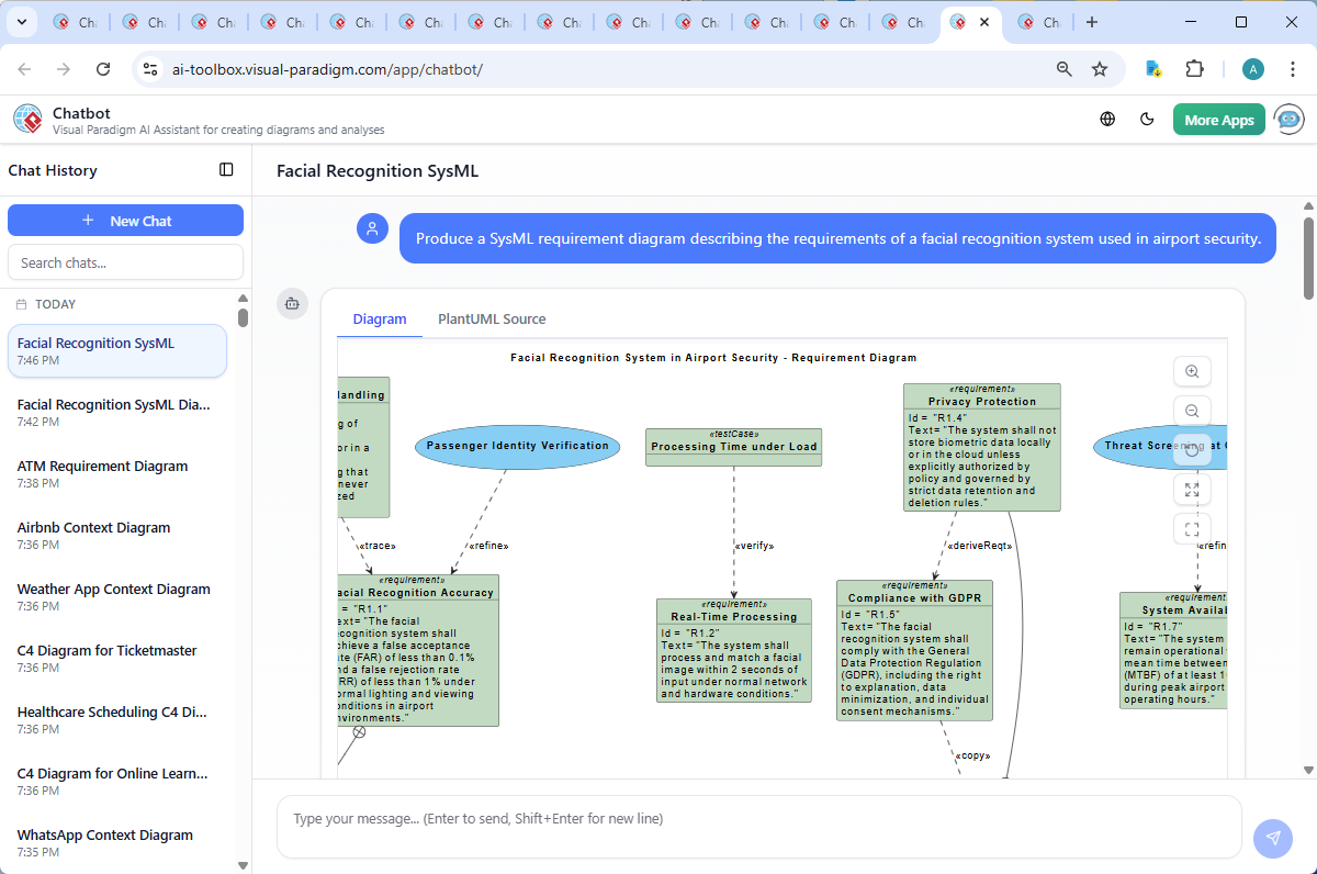

The journey began with a simple request: “Produce a SysML requirement diagram describing the requirements of a facial recognition system used in airport security.” Within seconds, the AI Chatbot responded with a fully rendered PlantUML-based SysML Requirement Diagram, complete with traceability, refinement, and containment relationships. But the real value emerged in the conversation that followed.
When the user asked, “Can you explain how the system ensures privacy when facial images are processed in real-time during passenger screening?”, the AI didn’t just restate the requirement—it deepened the design by explaining how on-device processing, anonymized face embeddings, and user consent mechanisms work together to protect biometric data. This wasn’t a generic answer; it was a technical explanation grounded in real-world privacy frameworks like GDPR.
Following this, the user requested refinement: “AI, refine the logic around data retention and anonymization.” The AI responded by updating the diagram with a new requirement: “Anonymized Data Handling”, and linked it to the core accuracy requirement through a $trace relationship, showing how privacy controls directly support system reliability. This level of interactivity isn’t just about diagram updates—it’s about co-designing a secure, compliant system in real time.

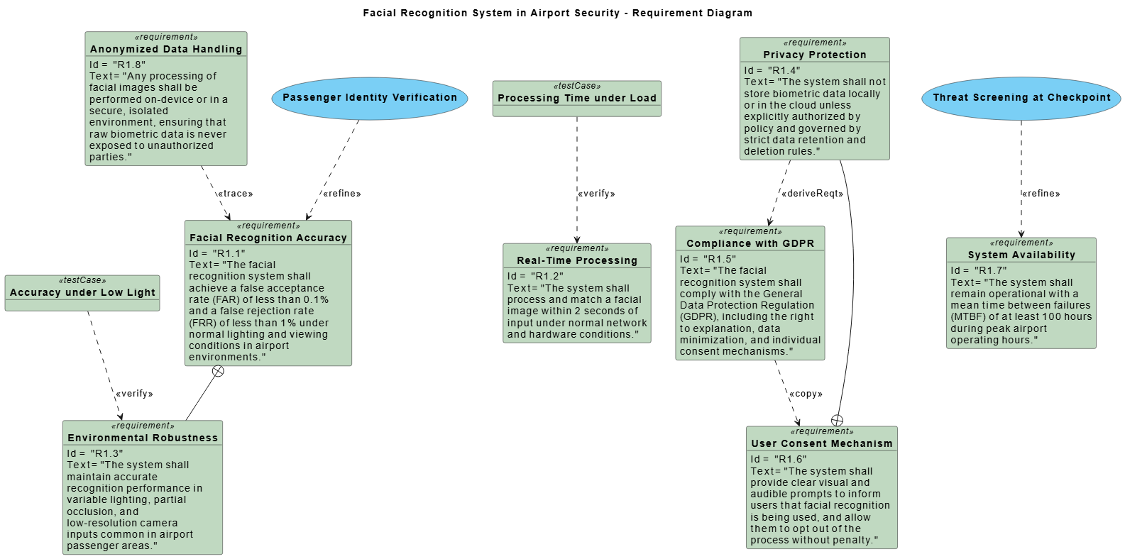

The diagram is built using SysML Requirement Diagram notation, which is ideal for expressing functional, non-functional, and compliance-driven requirements in a structured, verifiable way. Here’s how each element contributes:
  • Requirement IDs (e.g., R1.1, R1.2): Each requirement is uniquely labeled and traceable, enabling full auditability and compliance tracking.
  • Traceability Relationships: The $trace between req08 (Anonymized Data Handling) and req01 (Facial Recognition Accuracy) shows that privacy measures directly support accuracy—because anonymized processing prevents data leakage that could degrade model performance.
  • Refinement & Verification: $refine(useCase01, req01) links the use case “Passenger Identity Verification” to the accuracy requirement, ensuring the system’s purpose is clearly tied to measurable outcomes. Similarly, $verify(testCase01, req03) ties a test case to environmental robustness, confirming that validation is built into the design.
  • Containment & Derivation: $containment(req06, req04) shows that the user consent mechanism is nested under privacy protection, emphasizing that consent is not an afterthought but a foundational layer. $deriveReqt(req04, req05) illustrates how GDPR compliance is derived from privacy policy, creating a logical hierarchy of regulatory obligations.
This structure isn’t just visual—it’s design intelligence. The relationships enforce consistency, prevent requirement conflicts, and make the system easier to validate, test, and maintain.
