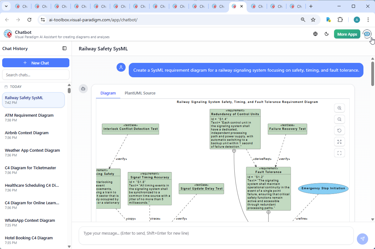

The process began with a simple prompt: “Create a SysML requirement diagram for a railway signaling system focusing on safety, timing, and fault tolerance.” The AI Chatbot immediately interpreted the intent and generated a fully structured SysML requirement diagram using PlantUML syntax, incorporating key safety and timing requirements.
But the real value emerged in the conversation that followed. When asked, “Can you explain how the fail-safe default state is implemented in the signaling system during a power loss?”, the AI didn’t just provide a definition—it delivered a detailed, technically grounded explanation that included:
  • Hardware-level power monitoring and emergency power switching
  • Software-based fail-safe logic and state transitions
  • Integration with redundant power supplies and manual override protocols
  • Alignment with international safety standards like EN 50126 and IEC 61508
Each response was not just informative—it was a design insight. The AI then used this knowledge to refine the diagram, adding traceability links and containment relationships to reflect real-world system behavior. For instance, it clarified that the “Fail-Safe Default State” (req06) is both a derived requirement and a containment of the broader fault tolerance strategy (req02).

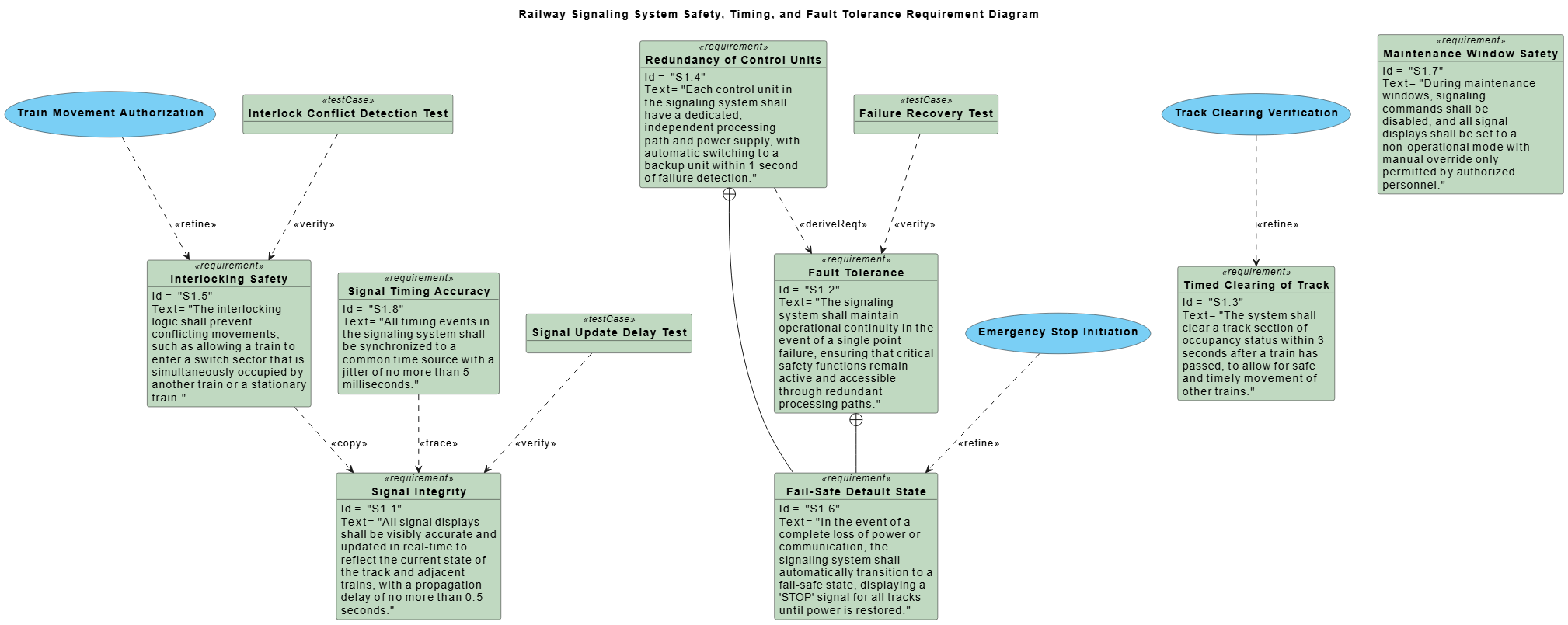

The generated SysML requirement diagram is not just a visual representation—it’s a living model of system safety. Here’s how each element contributes:
1. Requirement Clusters
  • Signal Integrity (req01): Ensures signals update in real time with a maximum delay of 0.5 seconds. This is critical for preventing train collisions due to outdated information.
  • Fault Tolerance (req02): Mandates that the system remains operational after a single point failure, enforced through redundant processing paths.
  • Timed Clearing of Track (req03): Limits the time to clear a track section to 3 seconds after train passage—ensuring timely availability for subsequent trains.
  • Redundancy of Control Units (req04): Requires dedicated, independent paths and automatic failover within 1 second—directly supporting req02.
  • Interlocking Safety (req05): Prevents conflicting movements—such as allowing a train into a track already occupied—by enforcing logical constraints.
  • Fail-Safe Default State (req06): Triggers a system-wide “STOP” state during power loss, ensuring no train proceeds into an unknown or unsafe condition.
  • Maintenance Window Safety (req07): Disables automatic signaling during maintenance, allowing only manual override by authorized personnel.
  • Signal Timing Accuracy (req08): Enforces synchronization across the system with a jitter of ≤5ms—critical for coordinated timing across distributed nodes.
2. Traceability and Validation
The diagram uses SysML’s $verify and $trace constructs to link test cases to requirements. For example:
  • $verify(testCase01, req01): The Signal Update Delay Test validates the 0.5-second propagation delay.
  • $trace(req08, req01): The timing accuracy requirement (req08) supports the signal integrity requirement (req01).
  • $refine(useCase01, req05): The “Train Movement Authorization” use case is refined by the interlocking safety requirement.
3. Hierarchical Relationships
Through $containment and $deriveReqt, the AI establishes logical dependencies:
  • $containment(req04, req06): Redundancy (req04) is a means to achieve the fail-safe state (req06).
  • $deriveReqt(req04, req02): Redundancy is a specific implementation of fault tolerance.
These relationships ensure that the model is not just a list of requirements—it’s a coherent, traceable, and maintainable system architecture.
