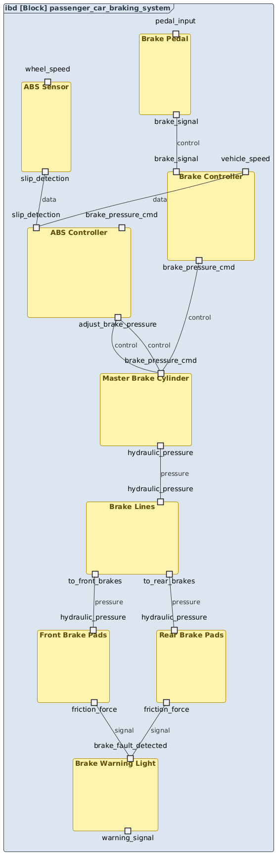

The process began with a simple request: “Generate a SysML Internal Block Diagram to visualize how major components of a passenger car braking system interact to safely slow and stop the vehicle.” Within seconds, the AI delivered a fully structured SysML IBD, complete with components, ports, and connection types—using the plantuml syntax standard for precise modeling.

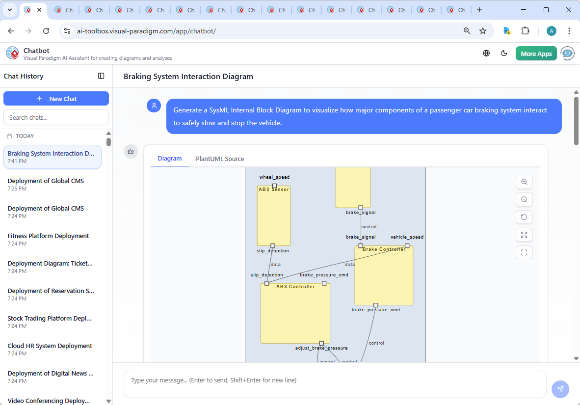

But the conversation didn’t end there. The user followed up with a critical question: “Can you explain how the ABS controller uses slip detection data to adjust brake pressure in real time?” This wasn’t a request for a diagram update—it was a request for deeper technical insight.
The AI responded with a layered explanation that unpacked the physics and control logic behind ABS operation. It clarified how wheel speed sensors detect slip, how the ABS controller interprets this as a risk, and how it dynamically adjusts brake pressure through rapid pulsing—ensuring wheel rotation is maintained during hard braking.
This wasn’t just a description. It was a model-informed explanation, rooted in the structure of the diagram itself. The AI referenced the abs_sensor_slip_detection port, the abs_controller_slip_detection input, and the abs_controller_adjust_brake_pressure output—showing how the data flow and control loop were not just drawn, but functionally coherent.

SysML Internal Block Diagram of a passenger car braking system showing components like brake pedal, master cylinder, ABS controller, brake lines, and brake pads with labeled connections and ports.
AI Generated SysML Internal Block Diagram: Passenger Car Braking System Example (by Visual Paradigm AI)
Decoding the Logic: Why This Internal Block Diagram Works
The diagram captures the internal structure and interactions of the braking system using SysML’s Internal Block Diagram (IBD) standard. Unlike traditional block diagrams, IBDs show both the components and their internal connections, making them ideal for modeling systems with complex control and data flows.
Here’s how the key elements align with the real-world function:
  • Brake Pedal → Brake Controller: The driver’s input is converted into a control signal. This is the primary trigger for braking.
  • Brake Controller → Master Brake Cylinder: The controller sends a pressure command based on pedal force and vehicle speed. This is where hydraulic pressure is generated.
  • Master Brake Cylinder → Brake Lines: Hydraulic pressure is transmitted through the brake lines to both front and rear brakes.
  • Front/Rear Brake Pads → Friction Force: The pads apply friction to the rotors, slowing the wheels. This force is also used as a feedback signal for the warning system.
  • ABS Sensor → ABS Controller: Real-time wheel speed data is fed into the controller to detect slip.
  • ABS Controller → Master Brake Cylinder (via pressure adjustment): The controller sends a dynamic signal to modulate brake pressure, preventing lock-up.
What makes this IBD particularly effective is its use of port-based connections with semantic labels:
  • control for command signals (e.g., brake pressure command)
  • pressure for hydraulic transmission
  • data for sensor input (e.g., wheel speed)
  • signal for fault detection (e.g., low friction)
This notation ensures clarity and traceability—critical when validating safety requirements or performing system-level analysis.
The true value of the Visual Paradigm AI Chatbot lies in its ability to function as a technical collaborator. When the user asked for an explanation of the ABS logic, the AI didn’t default to generic text. Instead, it:
  • Referenced specific ports and connections from the diagram.
  • Explained the real-time control loop with measurable timing (e.g., 100 cycles per second).
  • Connected the technical behavior to safety outcomes (e.g., maintaining steering control).
  • Provided a concrete example of how the system behaves during an emergency stop.
This level of contextual understanding is rare in AI tools. The Visual Paradigm AI Chatbot doesn’t just generate models—it reasons about them, enabling users to explore edge cases, validate assumptions, and refine designs through conversation.
Screenshot of the Visual Paradigm AI Chatbot interface showing the conversation between the user and the AI, including the prompt, diagram generation, and follow-up explanation on ABS control logic.
