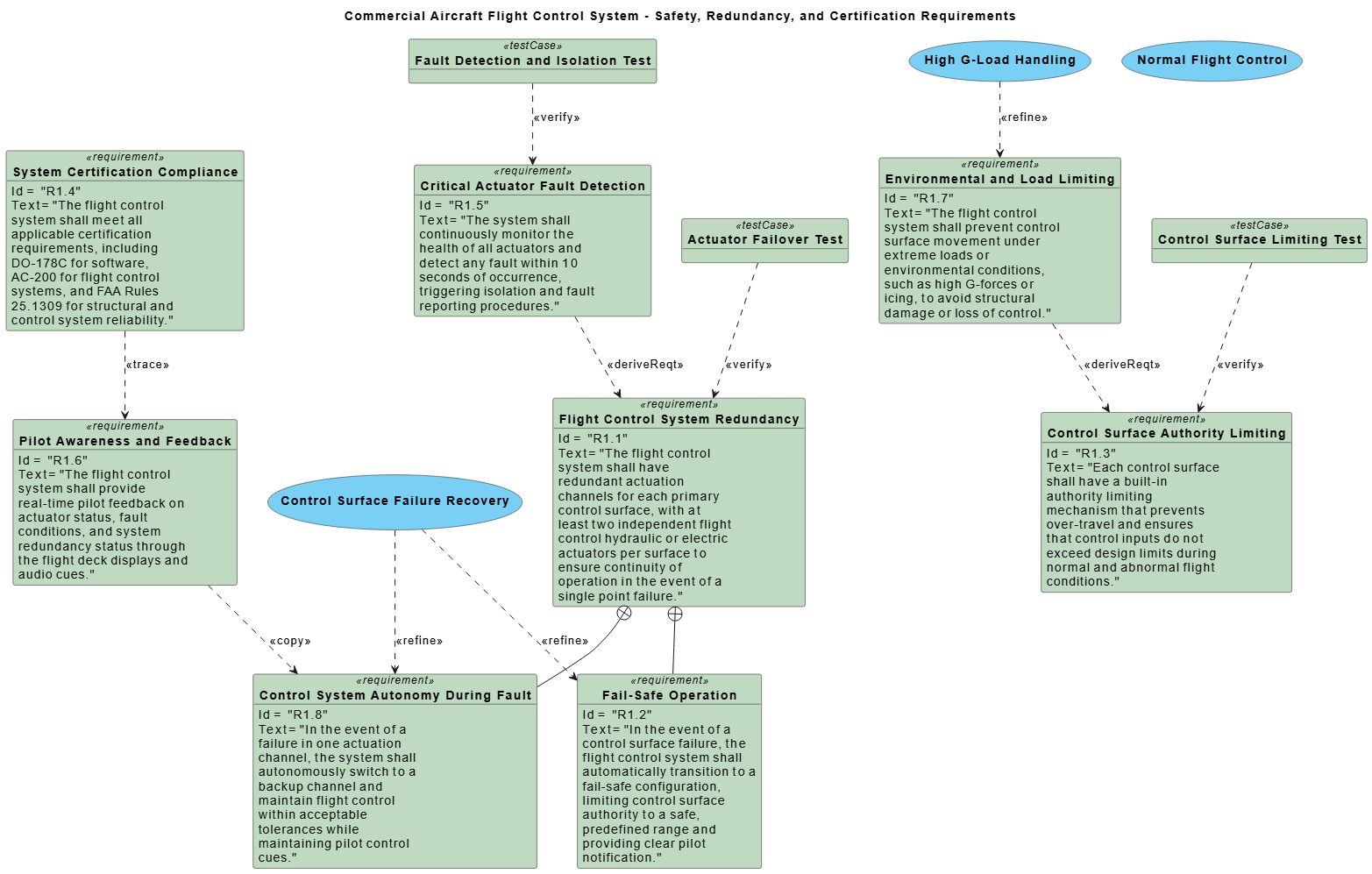

SysML Requirement Diagram for a Commercial Aircraft Flight Control System, illustrating safety, redundancy, and certification constraints with traceable relationships between requirements, use cases, and test cases.

1. Core Safety Requirements
  • R1.1 (Redundancy): Ensures at least two independent actuators per control surface, directly supporting system resilience.
  • R1.2 (Fail-Safe Operation): Mandates automatic transition to a safe state upon failure, reducing risk during emergencies.
  • R1.3 (Authority Limiting): Prevents over-travel and structural stress, protecting the airframe.
2. Verification & Traceability
  • $verify(testCase01, req01): Links the Actuator Failover Test to the redundancy requirement, ensuring it can be validated.
  • $trace(req04, req06): Shows that certification compliance (R1.4) is linked to pilot awareness (R1.6), reinforcing the human-in-the-loop safety model.
  • $deriveReqt(req05, req01): Indicates that fault detection (R1.5) is derived from the redundancy requirement—meaning it’s a necessary consequence of having redundant channels.
3. Logical Relationships & Constraints
  • $containment(req01, req08): Demonstrates that the autonomy during fault (R1.8) is contained within the broader redundancy framework (R1.1).
  • $refine(useCase02, req02): Shows that the failure recovery use case is refined by the fail-safe requirement, ensuring operational clarity.
  • $copy(req06, req08): Indicates that pilot feedback (R1.6) is copied into the autonomy requirement, emphasizing that autonomy must be transparent to the pilot.
This layered approach ensures that every safety constraint is not only defined but also verifiable, traceable, and interconnected—critical for certification audits and system validation.

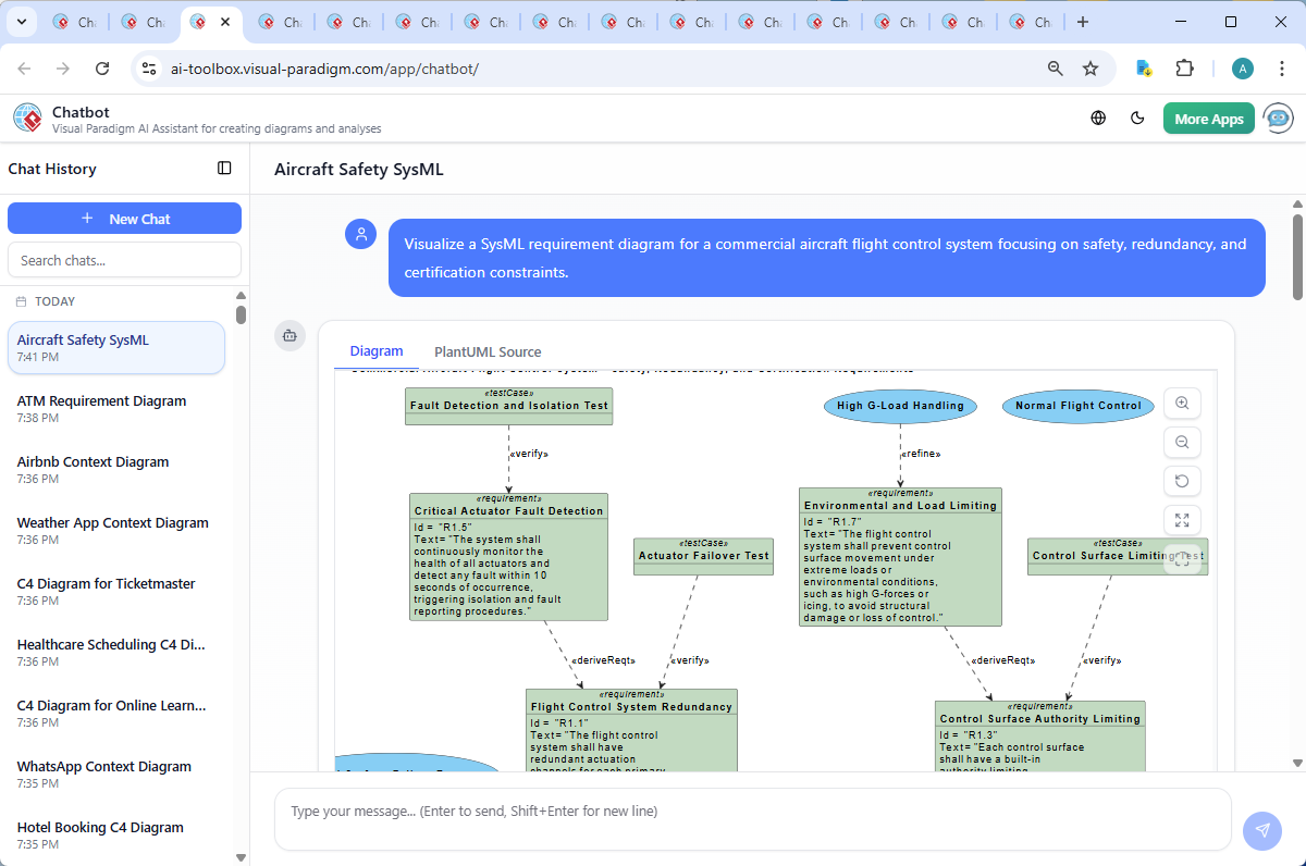

Screenshot of the Visual Paradigm AI Chatbot interface showing a live conversation about flight control system safety, with real-time diagram generation, requirement tracing, and follow-up clarifications.
