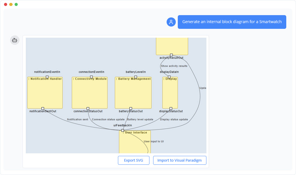

- Automated “Wiring”: Describe the connections between parts in natural language, and the AI will instantly generate the IBD with all the correct ports and connectors. This eliminates the tedious manual process of drawing and aligning lines.

- Defining the Context: “Create a SysML Internal Block Diagram for the ‘Computer’ block.”
- Adding Parts and Ports: “Inside the ‘Computer’ block, add parts for a ‘CPU’ and ‘RAM’. Add a port named ‘dataBus’ to both parts.”
- Connecting Parts: “Draw a connector between the ‘dataBus’ port on the ‘CPU’ and the ‘dataBus’ port on the ‘RAM’.”
- Analysis: “Based on this IBD, list all the parts that the ‘CPU’ is directly connected to.”
